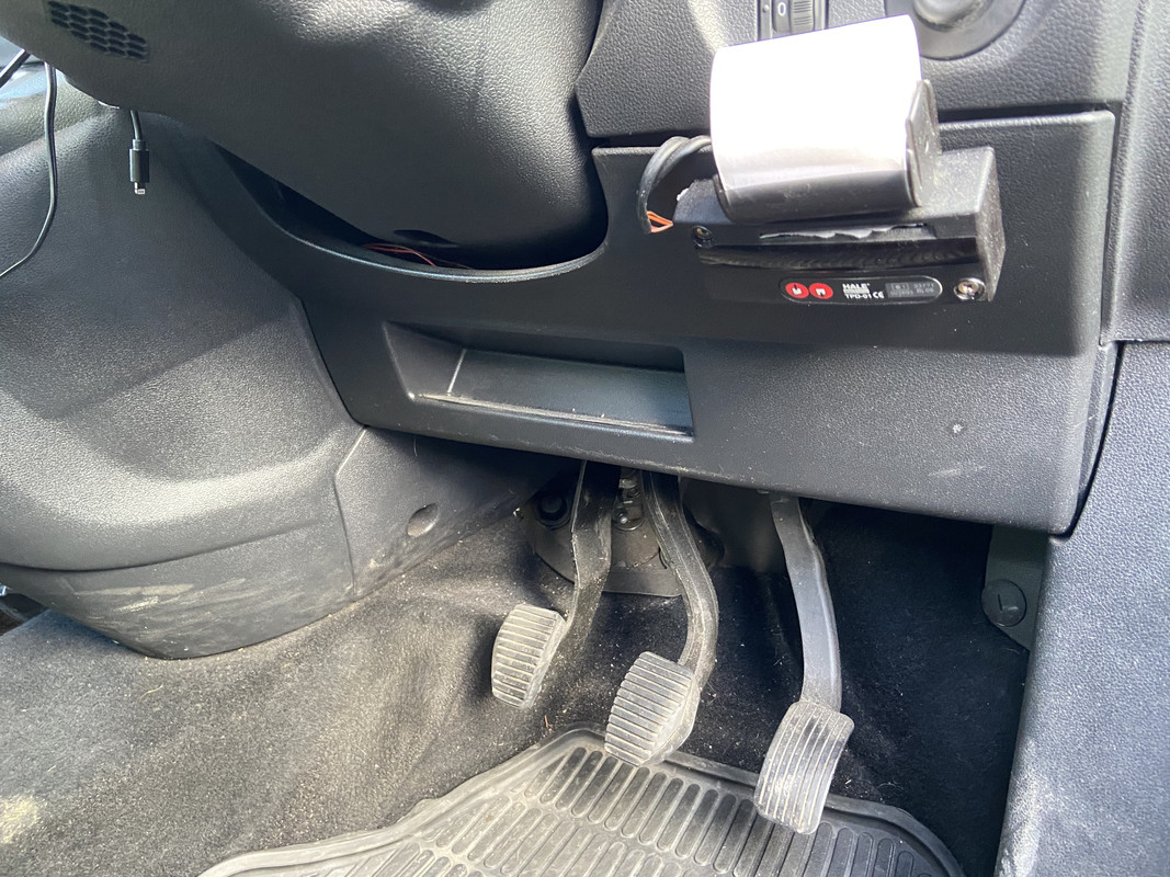

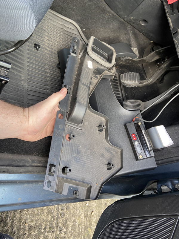

Changed the pollen filter / cabin filter today between the rain showers

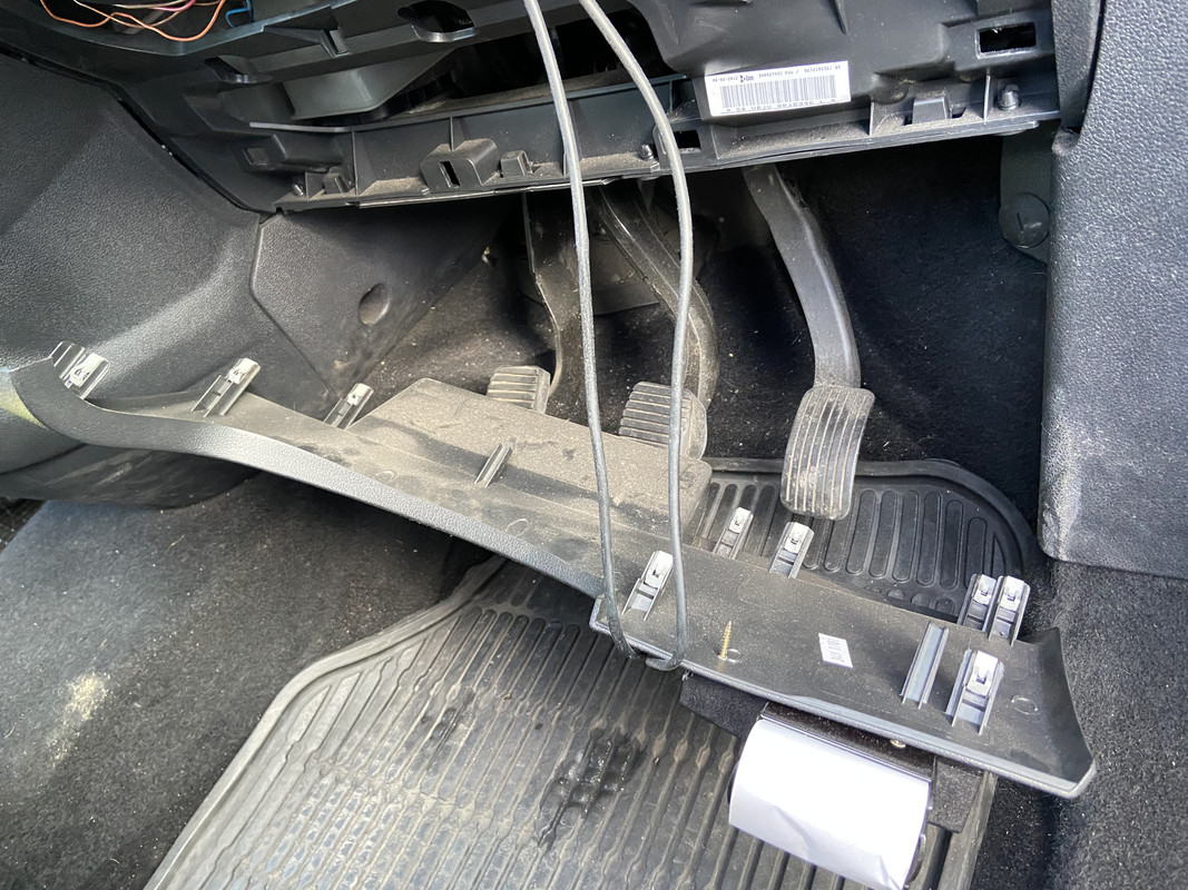

Under the steering column theres a knee panel that pulls of handy enough with no tools needed

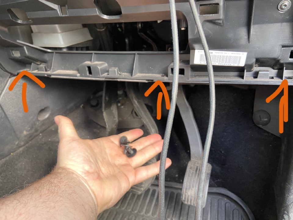

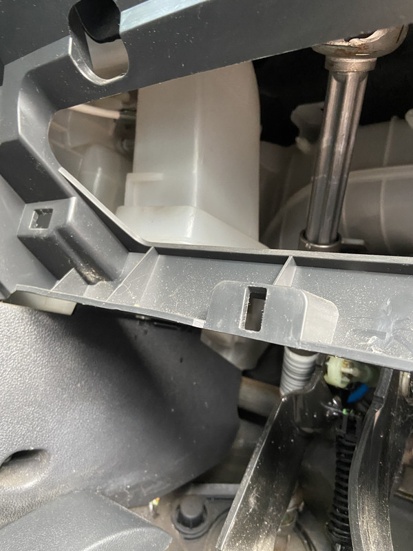

Once ya have the knee panel theres another panel to be removed with 3 retaining clips pointed out below

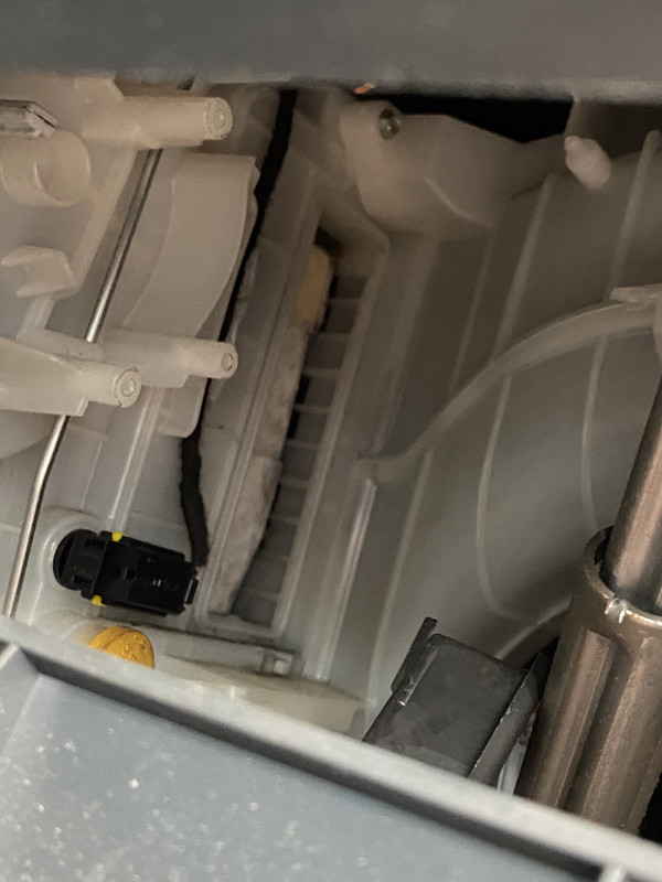

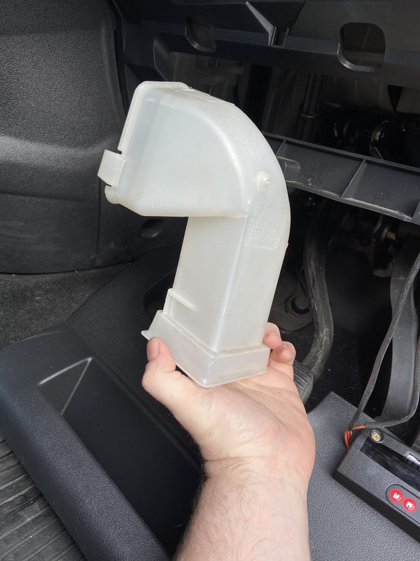

Looking up into the firewall theres a duct to be removed for access, it pulls down with minimal force

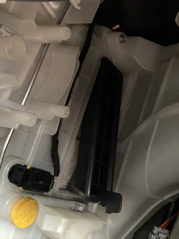

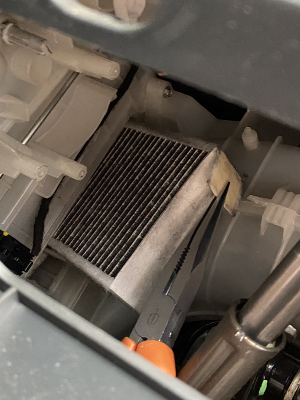

Once you've removed this ducting you'll see a rectangular black cover, clip off the cover and you can access the filter

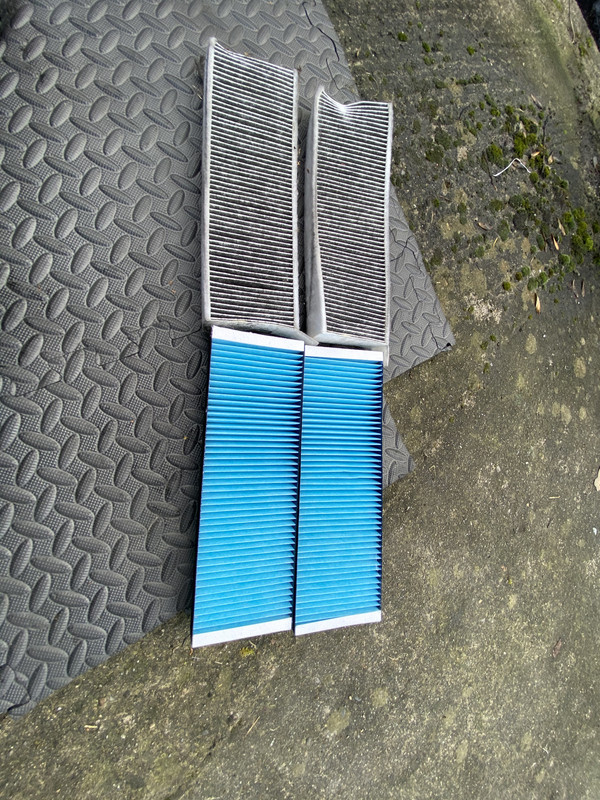

Using a pliers pull out the two filters, its in two pieces, as i feared the filter has never been changed. Once ya have it out compare it against the new filter, compare dimensions different styles and colours is moot

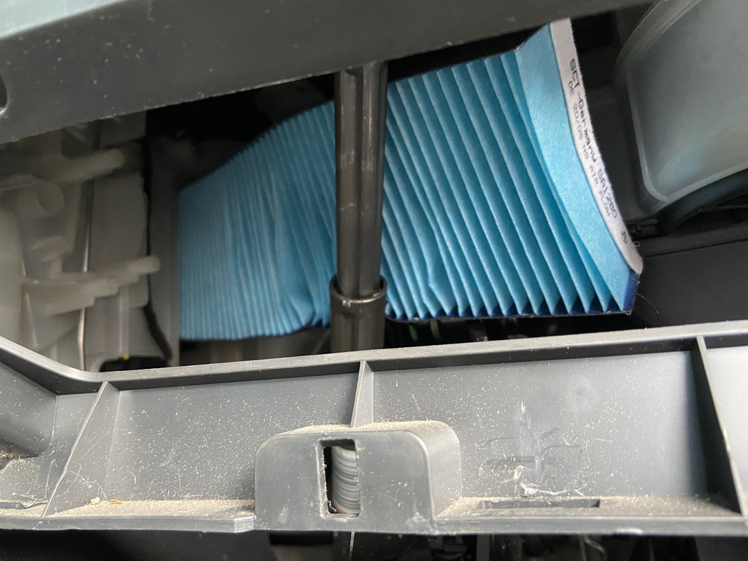

Replace the filters with the new ones, in hindsight I'd go for higher quality filters as they have a harder quality to them and makes it inserting into the filter housing easier, with the lower quality/cheaper filter that I have it makes it harder to insert it into the housing as it was getting snagged.... however thats a problem for future Panel!
