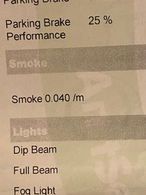

I'll get that NCT emmisions result fer ya in a mo, it's out in the car.

Fer emmissions I hope you mean Smoke on the NCT ?

That Smoke number is low for a car with DPF problems just a few weeks after the test .Did your Spanner Jockey ever say what caused your Turbo to give problems ?you said your oil was 3/4 full thats a lot of lost oil it has to go somewhere  it might be effecting your turbo and clogging the DPF .
