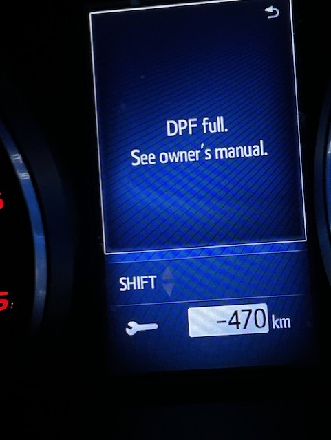

For Ken really, I guess.
I was chatting with a man in a public house recently who's had nothing but expensive trouble with his Toyota DPF. During the conversation I recalled reading that VAG DPFs won't regenerate automatically - something they do quite frequently - unless there's more than 1/4 tank of diesel available. I've since double checked the service manual and that is correct. Now, I think I recall you (Ken) telling me that you never fill your tank, opting to minimise weight instead. Might be worth checking with a Toyota service manual or expert if Toyotas behave in a similar fashion...
Thanks Stephen, sorry fer late reply, only just seen this topic now.
You did indeed mention the same before a few years back and since then I have always kept my diesel tank at over 3/8 full as you suggested back then.
The final cost to me in ready notes fer my DPF filter replacement after trying various services and excluding time lost and transport to variuos services was a whooping 7.5K. (Long story).
It was just before Chrimbo that I paid the last 5K to Toyota fer a replacement DPF and it stung like a Bitch, I paid it and shrugged it off and forgot about it. I will never ever drive another Diesel car again.

The dpf can be removed / bypassed or whatever they do. You still pass your ncts no problem.
Would you Fookin Adam and Eve it !
ken all you havta do is use dipetane consistantly.
it makes the diesel burn completely.
pour a bottle in and do a few laps at 2000rpm of the m50 in cork or whatever it's called and wait for the dpf to get cleaned out and the dpf message will dissapear. she has the same car i havta do it for her a couple of times a year.
