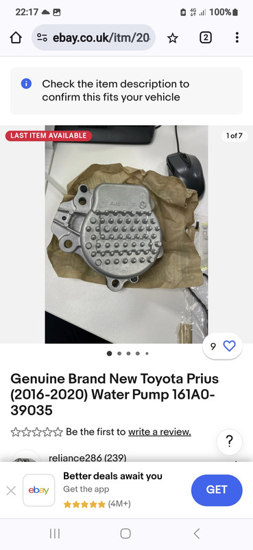

« Reply #7 on: July 24, 2024, 10:18:41 pm »
It looks like the water pump is electric ...but not sure ...if it is ... then the fast idle is still a mystery  oops
