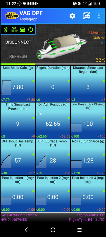

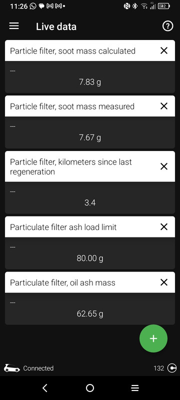

I've done a couple of screenshots from the VAG DPF app and OBD Eleven (below) to give you some idea of what you can expect from them. I've also included a couple of relevant links that you might find interesting. One of those suggests periodic cleaning (as you done on your C5) extends intervals between regens which would save fuel as during an active regen the car injects diesel on the exhaust stroke as well as the compression stroke to get the DPF/Exhaust burning.
Just a minor aside... in my last post on DPF soot/ash levels I mixed up the soot and ash. It's the ash that congeals and eventually kills the DPF not the soot!
VAG DPF app screenshot:
OBD Eleven Screenshot:

Looking at the VAG DPF screenshot above it seems my DPF soot level is at 33% despite the last regen being 3 kilos ago. That can't be good. I'm half tempted to do something I've never done before i.e. add some stuff to the diesel. I've never put anything other than bog standard EN590 diesel (as per manufacturer specs) in any my Octy diesel tanks. What a conundrum!

I might give that a go on my own in due course. In fact my latest reading disproves my previous theory that one could calculate the kilometreage from the Ash level. The reading before that was 50.08g/80.00g at 200,035 kilos which is bang on the formula I had previously observed (320,000 / 80 * 50.08 = 200,320)... as were several Audis I looked at with the brother a few years back so the relatively large deviation at this juncture is definitely cause for concern. 320,000 / 80 * 62.65 = 250,600 yet the actual kilometreage is 242,901. I know it hasn't been clocked so the increased ash accumulation must have a cause... unless it's just programmed to speed up as it gets near the end of it's life. It'd certainly be interesting to see what (if any) effect cleaning has on the numbers.
