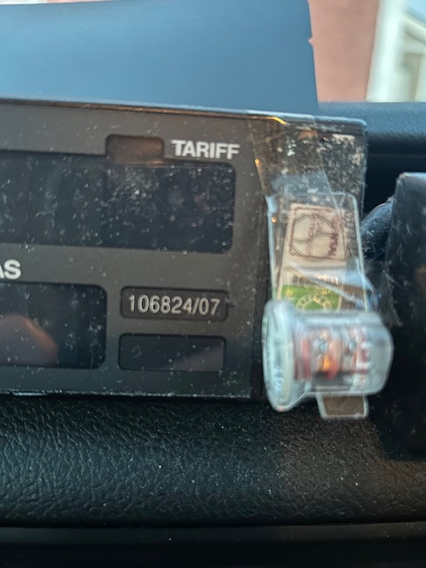

I rang my local meter reprogrammer last Friday and he told me that the Hale Microtax prior to 2005 was now obsolete.
He said that as my Hale Microtax serial number, which is shown on the front of the meter, shows '07' as the last 2 digits means that it was manafactured in 2007 and is good to go, ..... but I'm guessing good to go fer just another 2 years ??
Look behind the meter, MCT 05 you’ll have to buy a new meter, MCT 05+ you’ve another year until

« Reply #6 on: November 25, 2024, 08:59:31 am »
....  Look behind the meter, MCT 05 you’ll have to buy a new meter, MCT 05+ you’ve another year until
Your goosed
Thanks fer that Panel, I just looked behind my Hale meter and it states MCT 05+.
.....  The simplest way to identify a MCT-05+ is to have a look at the taximeter's e1-certification mark, which clearly shows "MCT-05+" . This label was usually placed on the back of the taximeter. (The MCT-05+ will operate normally until 31st December 2025)
