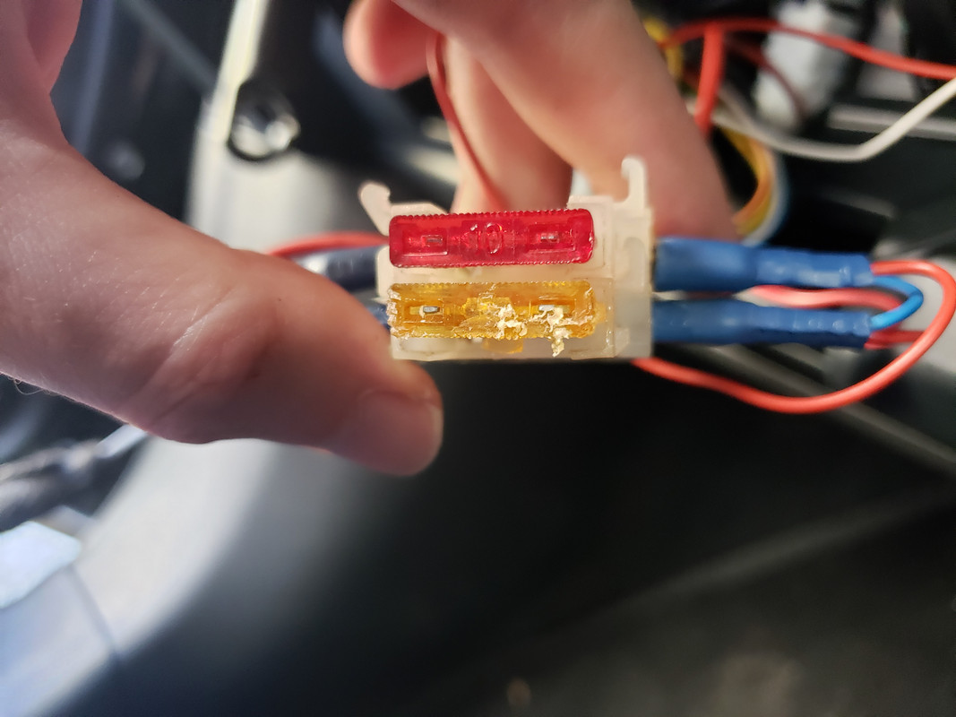

meter beeped and went dead once or twice last week and was totally dead yesterday. i fiddled with the wiring and noticed that when i press down hard on the yellow 5 amp blade fuse i replicated the problem. new fuse problem solved. the damage to the top was from trying to pull it out with a little pliers.
